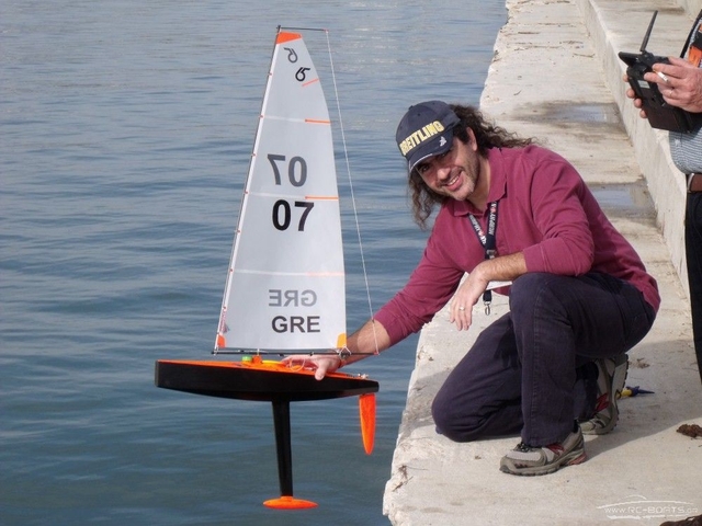

Hello again.
After 4 months, various problems and mistakes I finally baptized Ocypète (Ωκυπέτη).
Unfortunately there was no air so we had to postpone yesterday's races and my tests. Here is a photo of her just before her first swim and a short video of yesterday's event, where only the "M" class boats managed to race.

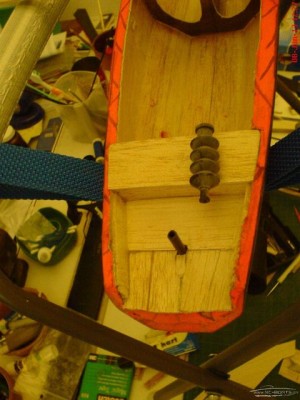

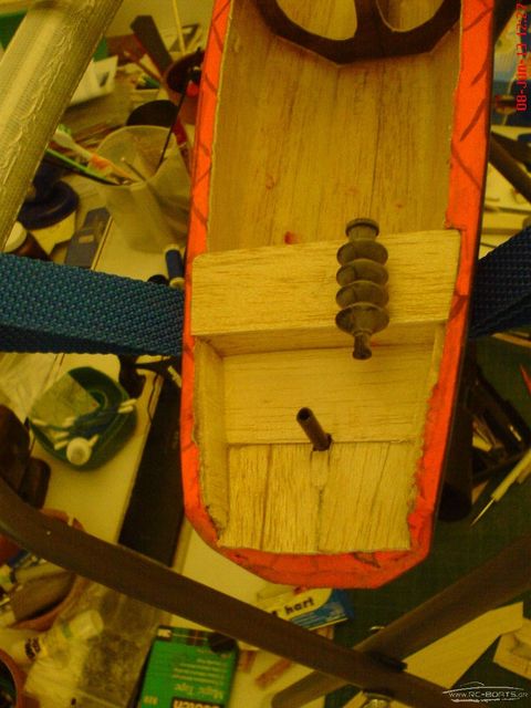

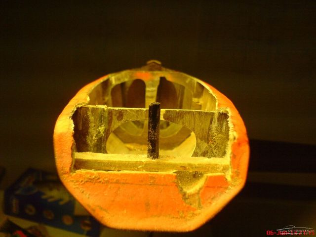

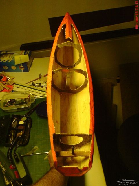

Beitrag: #30Beitragvon abi » 10.06.2013, 06:48
Four months in limbo….and suddenly a medium earthquake shook Athens. Then some summer rains…it didn’t take much for my head to spin.
IT’S DREMEL TIME.
Poor Ocypete stood there patiently as I unleashed my fury upon her. Two starless nights later and this is how she ended up looking. There is even a whole just in front of the keel as I was trying to remove the previous winch stand and the drill went all the way through.
The stern was redesigned to be able to lower the rudder servo and keep its arm outside the boat.
I still haven’t decided about where the sail line will exit but there is much to do till then.
Now I have two things to workout: What kind of sail should I use and if the Hobbyking 6CH TX helps with the six rotations the winch takes, so I may gain speed in line movement.
